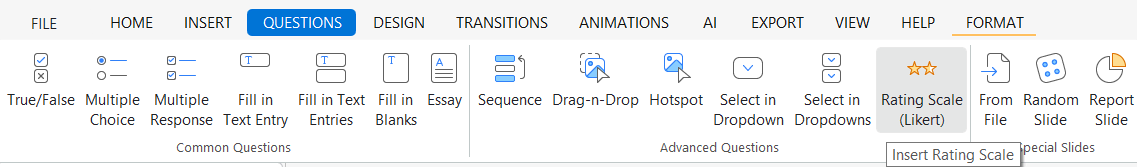

Rating Scale (Likert) is one of the 13 interactive questions that Active Presenter 10 offers to users. To insert a Rating Scale (Likert) question, do either of the following:
  • In the Questions tab > Rating Scale (Likert).
  • In the Home tab > Interactions > Rating Scale (Likert).
Rating scale (Likert) question in the Questions tab

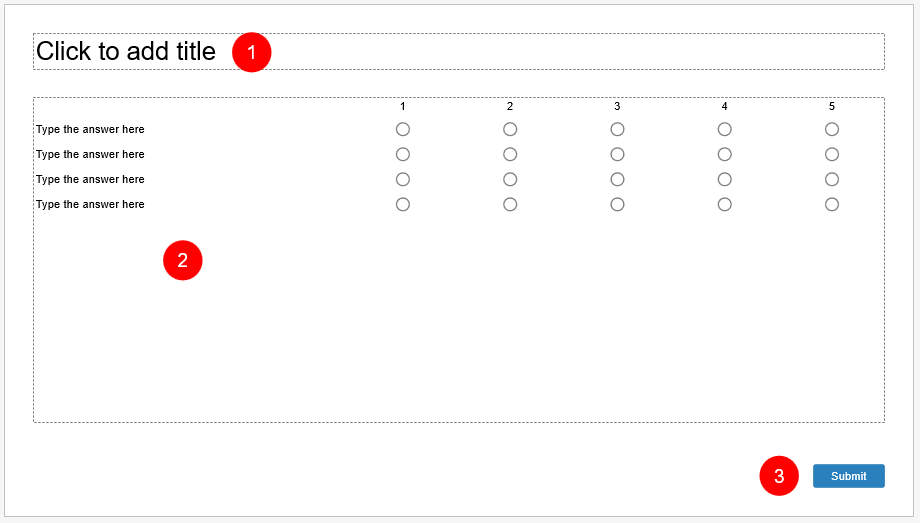

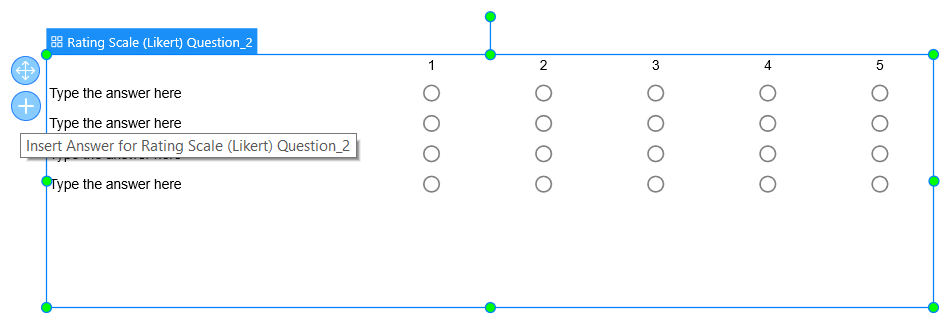

After that, a new Rating Scale (Likert) question slide will appear as in the image below. As you can see, it includes the top text box (1), the answer area (2), and the Submit button (3). There are two main parts in the answer area: the statements and scale options ranging from one extreme to another, with a neutral option in the middle.
insert a Rating scale question for the Likert scale survey

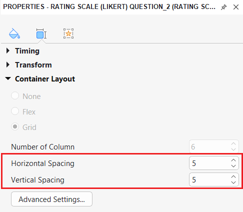

  • Customize the container layout properties: Rating Scale (Likert) questions have the Grid container layout by default. Note that it is impossible to change this default layout. You can only change the Horizontal Spacing and Vertical Spacing:
See Container Layouts of Questions for more details.

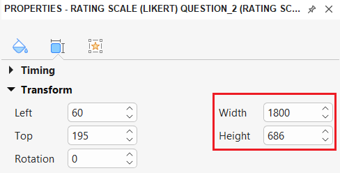

  • Resize the question title (1) and the answer area (2): You can resize these sections by selecting them and dragging the resizing handles. Or, select them, then go to the Properties pane > Size & Properties tab > Transform to adjust or type the value in the Width and Height combo box:

  • Add more answer labels: To add more answer labels, select the answer area and click the green plus button:
Add more answer labels to the Rating scale question for the Likert scale survey

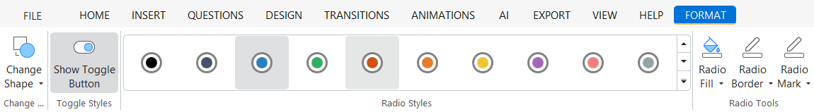

  • Format answer labels/ scales: Select the answer label, then open the Format tab, choose one style that you like from the Quick Styles section. Or, use tools in the Style Tools section to customize it.
  • Format radio buttons: Select the answer area, then open the Format tab, choose one style from the Radio Styles section. Or, use tools in the Radio Tools section to customize it.

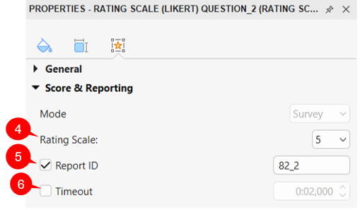

As said earlier, Rating Scale (Likert) questions are preferably used in survey forms. Therefore, unlike other question types in ActivePresenter, this type of question only has the Survey mode. The Graded mode is not available. That’s why it’s impossible to set correct answers and points for it. Instead, you can change the number of rating scales.
To do that, select the answer area. Then, go to the Properties pane > Interactivity > Score & Reporting. Select a number from the Rating Scale list (4) or enter a number (between 2 and 10) in the Rating Scale combo box.
Set Scales and Reporting
Besides, you can also change the default Report ID (5) and set Timeout (6) for the question.

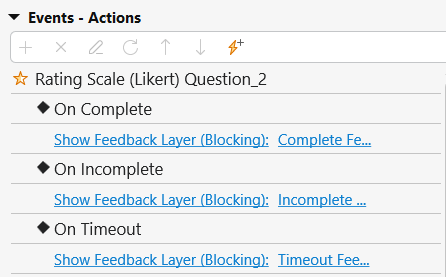

ActivePresenter 10 offers default events and actions for Rating Scale (Likert) questions in the Likert scale survey. Generally, the question has three default events, which are On Complete, On Incomplete, and On Timeout
Add Events and Actions to the rating scale question
You can remove, change, or make events and actions as more advanced as you wish. To do that, first, select the answer area. Then, access the Properties pane > Interactivity tab > Events – Actions.
