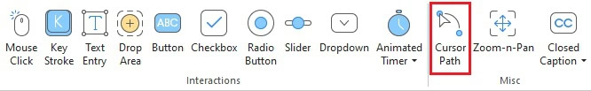

Step 2: Access the Insert tab > Cursor Path.
Insert Cursor Path object from the Insert tab

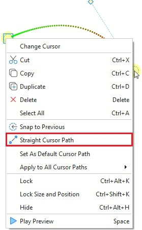

Any given path segment can be made a curve or a straight line. Just right-click the start point > Straight Cursor Path or Curved Cursor Path.
Change the Path of Mouse Movements

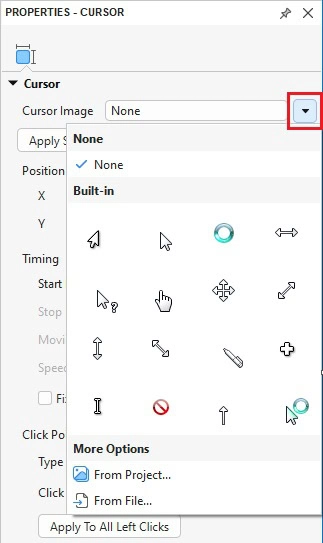

Step 1: Click the Properties pane > Size & Properties > Cursor > Cursor Image.
Change cursor image
Step 2: Choose the cursor image you want from the gallery. You can even use your own cursor image by clicking From File….

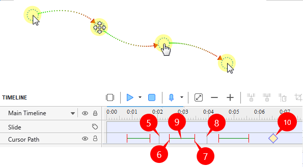

Take a look at the cursor movement in time. The cursor path has three segments in total.
Change timing and speed of mouse movement
  • Each gray vertical line (5, 8) denotes the end time of a segment and the start time of the subsequent segment.
  • The instant when the cursor starts moving is marked with a red vertical line (6).
  • During the 5→6 gap, the cursor is at rest. This is the start duration of the cursor.
  • The instant the cursor stops moving is marked with a second red vertical line (7).
  • During the 7→8 gap, the cursor is at rest. This is the stop duration of the cursor.
  • The green horizontal line (9) indicates the moving duration of the cursor.
  • The yellow diamond (10) represents a click point. This is where ActivePresenter simulates a click by creating a click sound and click effects.
You can drag the lines above to change where the movements of the cursor begin and how long they last. Alternatively, click the Properties pane > Size & Properties > Cursor > Timing to adjust the timing and speed of the mouse movement.

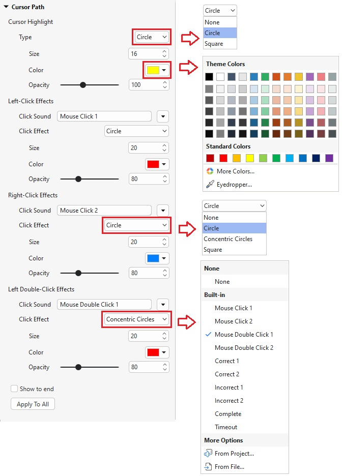

Inserting cursor effects may help viewers easily follow the content. To do that, select one point on the path then go to the Properties pane > Size & Properties tab > Cursor Path. Next, you are free to customize the cursor highlight, click sound, and click effects the way you want.
Modify the mouse cursor effects the way you want.

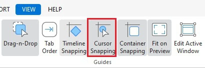

Normally, when you drag the start or end point of a cursor path object, ActivePresenter 10 also moves the corresponding point in the previous/next slide to ensure smooth mouse movement. That’s thanks to the Cursor Snapping tool in the View tab.
If you don’t want the cursor path to move continuously between slides, click the View tab and turn off Cursor Snapping.
Cursor Snapping in the View tab

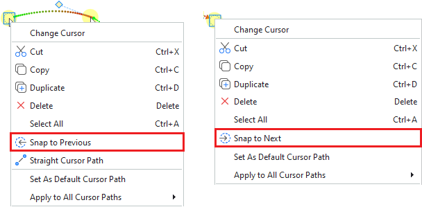

In rare cases, the cursor path can be out of sync, making an abrupt movement of the mouse cursor when transitioning between slides. To avoid this, stitch the ends of the cursor path objects of adjoining slides together.
  • Right-click the start point > Snap to Previous.
  • Right-click the end point > Snap to Next.
Continue Cursor Paths between Slides
