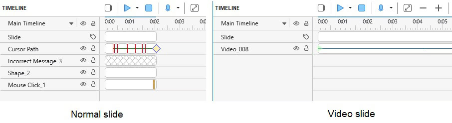

- A series of slides you get after recording an interactive simulation can be normal or video slides. In the capturing phase, whenever you scroll the mouse or carry a drag-n-drop action, ActivePresenter 10 automatically switches to the Full Motion Recording mode (Video) to capture it. Otherwise, the app switches back to the previous capture mode (Slide).
- Active Presenter 10 can automatically create slide names, smart annotations, cursor paths, mouse clicks, key strokes, text boxes, and feedback messages. As a result, you can save a lot of time and effort during the editing process.
- In the normal slides, you may get the following objects: cursor path, incorrect messages, shape, and mouse click. But in the video slides, there is only one video object. The image below shows details.

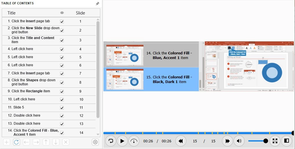

Slide names and slide descriptions are useful when you wish to export interactive simulations to HTML5 or document outputs. Recall that ActivePresenter offers auto-created slide names. These names are generated based on what you do with the captured application. You can edit the slide names easily in the editing phase. Also, you can add slide descriptions to give more information about any procedure.
To edit slide names and insert slide descriptions, go to the Properties pane > Slide Properties. Then, work with the Name and Description boxes. See Add Slide Names and Numbers to learn more.

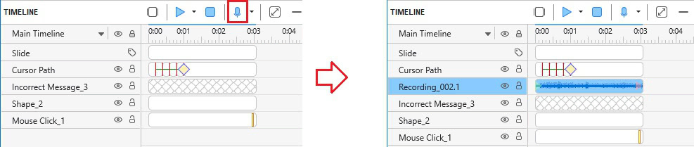

Record Narration
When the recording audio feature is turned on, the recorded audio may be inserted into different slides. So, you should not record audio and simulation simultaneously. Instead, it is possible to record voice when the recording is finished.
That is, you can insert narration (also voice-over) into a slide during the editing phase. This feature comes in handy when you want to create interactive simulations with voice prompts.
