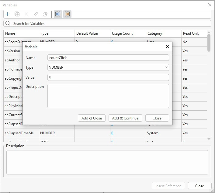

You only need one variable in this example to count the number of mouse clicks. To create a number variable, you access the Home tab, then click on Variables
open Variable dialog
In the Variables dialog, click the Add ( + ) button on the top toolbar to add a new variable, select the NUMBER type, and define its initial value if any.
After that, click Add & Close to finish.
Now the number variable is created. The next step is to create actions that calculate the number of clicks.

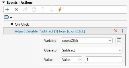

In this step, you need to add events-actions to make the counter work. Particularly, it’s necessary to add the Adjust Variable action to each ‘+’, ‘-’, and Reset buttons of the click counter. Firstly, you select the ‘+’ button and navigate to its Properties pane > Interactivity > Events – Actions. Then add the On Click event and the Adjust Variable action. You set to add 1 point to the number variable when clicking the ‘+’ button like this:
Similarly, you continue setting to subtract 1 point from the variable when clicking the ‘-’ button:

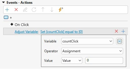

For the Reset button of the click counter, you set the number variable to be equal to 0:
