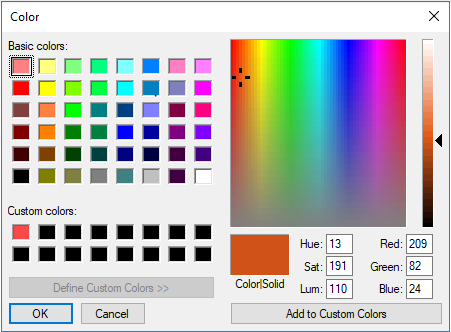

As you can see, the Create New Theme Colors dialog has two main sections: Theme Colors and Sample. The first shows 12 current Theme Colors. And, the second is where to preview the changes you make. This dialog allows you to specify your color preferences. Do that by clicking each Color Picker.
These color choices also determine preset colors available when you select fill and outline colors for objects. So, be careful!
Tip: When specifying colors, especially accent ones, it’s better to look at the Sample box. This box gives you a preview of changes. So, you know how a color looks next to another in a column or bar chart.

As said earlier, the theme colors consist of 12 colors, including four text/background colors and eight accent colors. Once you already created custom Theme Colors, the Color Picker will have new tints and shades automatically created by ActivePresenter. It’s impossible to control how tints and shades are defined. But you can adjust them by clicking More Colors. Note that shades and tints can be slightly different, depending on the used Theme Colors.
More Colors
The order of 12 colors is very important. That is, the order of text and background colors defines which color will be used as the default text color and default background. Dark 1 and Dark 2 should always be dark colors. At the same time, Light 1 and Light 2 should always be light colors. With these in mind, a good choice is to keep black and white among the first four text and background colors.
