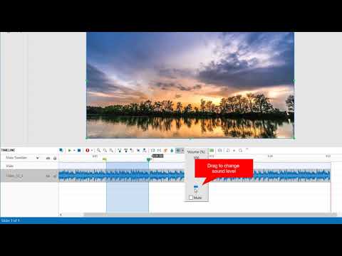

To change the sound for a specific part of the video/audio, take the following steps:
Step 1: Select the audio track in the Timeline pane, Selection pane or Canvas.
Step 2: Define the audio range in the Timeline pane. Just drag the green and yellow marker along the Timeline ruler to select the range.
Select audio range
Step 3: Click the Adjust Volume button (1).
This opens the dialog where you can scale the volume from 0 to 500. Check the Mute check box to silence the track.
Adjust Volume
Note: This is a relative volume scale with a default value of 100% (means original volume). It lets you adjust the volume from 0 (means mute) to 500% (means original volume x 5).
