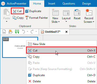

Cut Slides
Step 1: Select one or more slides you want to cut from the Slides pane on the left of the workspace.
Step 2: Do any of these ways to cut slides.
- Press CTRL+X.
- Click Cut
in the Tabbed Toolbar of the Home tab.
- Right-click selected slides > Cut
Step 3: Select the slide that you want to paste your cut slide after. Then, do either of the following:
