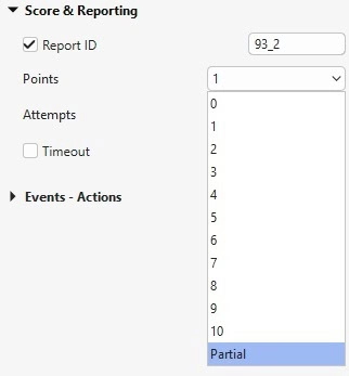

To assign points to a question, enter a number in the Points combo box or select a value from the Points drop-down list. By this way, learners will win that predefined point if they can completely answer the question correctly. Of course, there are no points given unless all correct answer options are selected.
Assign Partial Scores to a Question
On the other hand, you can set partial scores to a question. It’s the predefined points given for each answer option. Thanks to that, in some cases learners can still get scores even though they can’t find all the correct answers.
To enable the partial score feature, select Partial from the Points drop-down list:

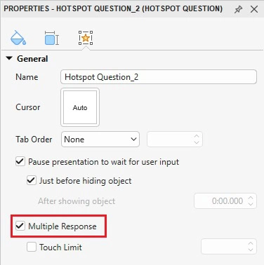

The Hotspot question requires learners to identify one or more spots on an image as correct answers. If the Multiple Response checkbox (Properties pane > Interactivity > General > Multiple Response) is selected, the way Active Presenter 10 calculates the total score is the same as that for Multiple Response questions. Learners will get no score if they define any spot wrongly. In case all selected spots are correct ones, the total points is the score of all correct hotspots.
If the Multiple Response checkbox is unchecked, the score of a Hotspot question is the score of the selected correct hotspot.
Take a look at this example:
Hotspot question
This Hotspot question requires learners to define 5 differences between two pictures. The correct hotspots are 5 green hotspots in the picture. With the Multiple Response checkbox selected, if learners define any spot beyond 5 green spots in the picture, they will get no score.
By contrast, if the Multiple Response checkbox is unchecked, the score learners get is the score of the selected correct hotspot.
